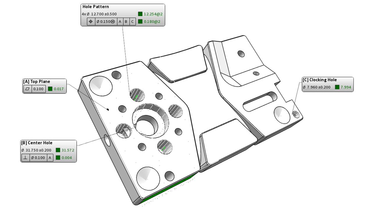

Individual Feature Reporting in BuildIT 3D View
PositionReportingFig1
Figure 1. Position tolerance annotation example for a 4-hole pattern: Only the worst individual feature’s value is shown in 3D annotation – in this case, the hole with index 2
Figure 1 represents the part we will analyze in this blog post. It is a view from the 3D display of BuildIT Software. The tolerance we will focus on is the position tolerance with respect to datum reference frame ABC on the 4-hole pattern (Figure 1: Hole Pattern).
In the 3D display, BuildIT only shows the value of the hole feature in the pattern with the worst position tolerance deviation value for clarity. In this case, it is the hole with index 2 in the pattern that gives the worst case, so it is shown in the annotation.

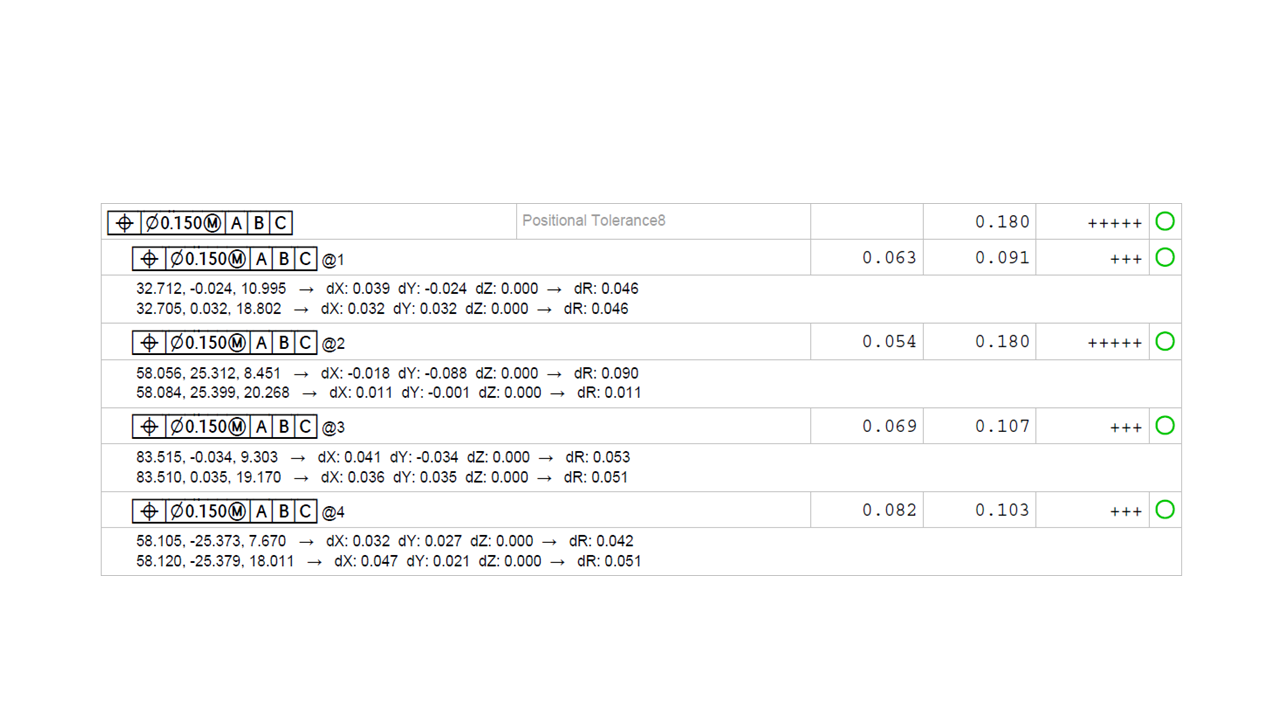

Individual Feature Reporting in BuildIT pdf report
PositionReportingFig2
Figure 2. Position tolerance results for the 4-hole pattern: All of the individual feature’s values are shown in the pdf report
We can see the position tolerance values of all individual features of the 4-hole pattern in the pdf report, as shown in Figure 2.

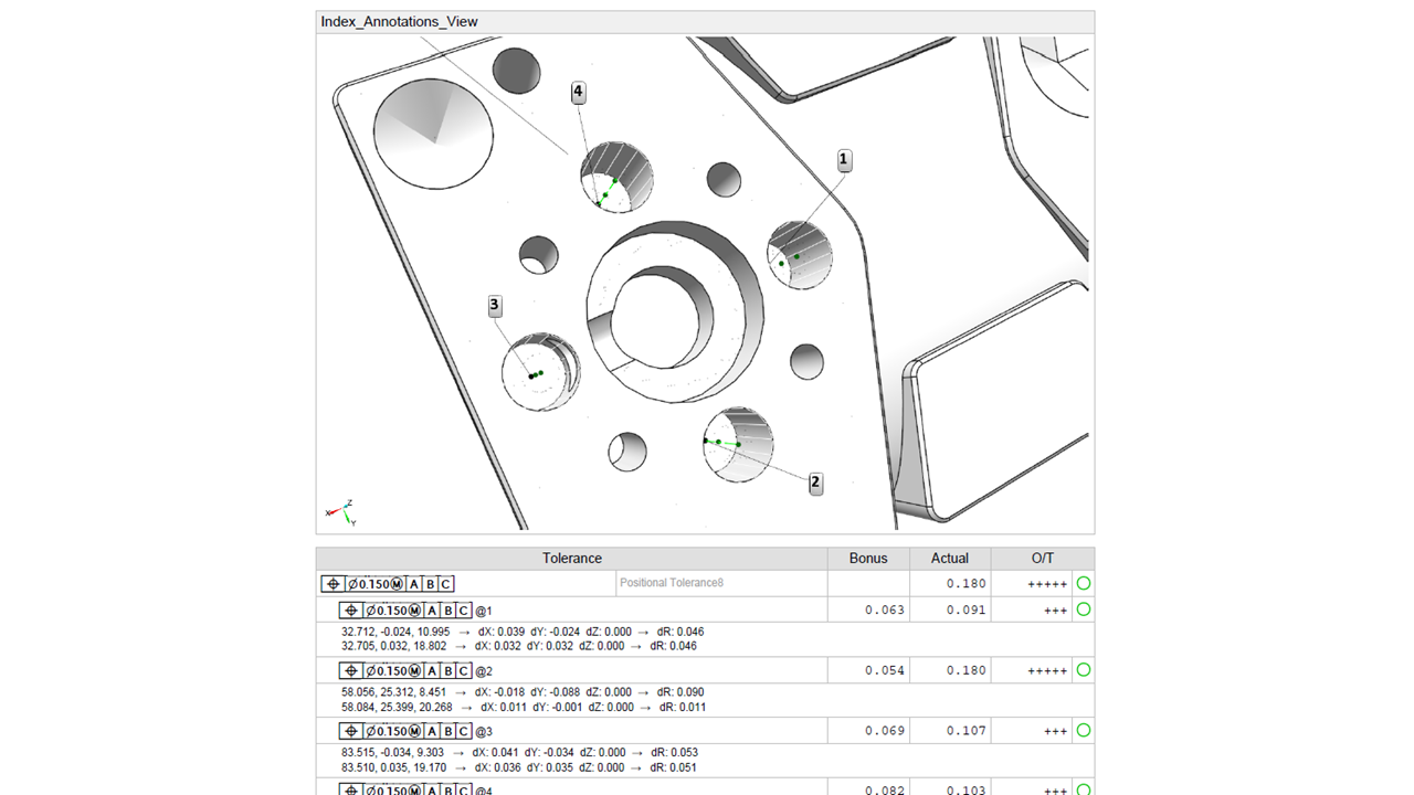

PositionReportingFig3
Figure 3. Hole indexes are shown for all hole features for the 4-hole pattern
Additionally, for each hole feature in a pattern of holes, hole indexes in the pattern can be observed, in the report or 3D view (Figure 3).

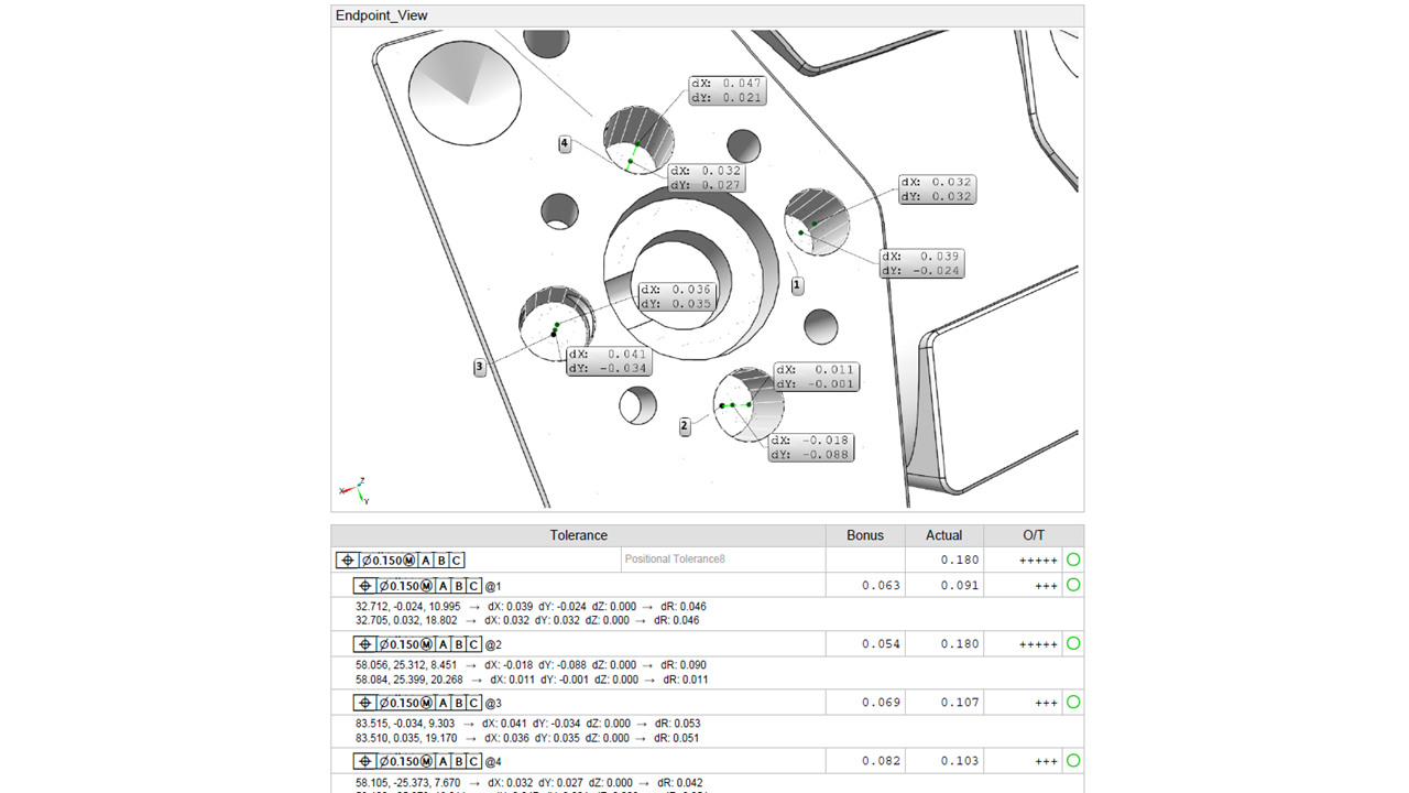

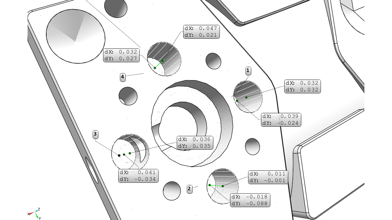

End Point Reporting in BuildIT 3D View
Analyzing endpoint information for each hole can also be crucial to observe the deviations of position tolerances. Again, endpoint information can be observed in BuildIT 3D view and pdf report, as shown in Figures 4 and 5.
PositionReportingFig4
Figure 4. Endpoint information about position tolerances in BuildIT software 3D view
End Point Reporting in BuildIT pdf report
PositionReportingFig5
Figure 5. Endpoint information about position tolerances in BuildIT Software pdf report
