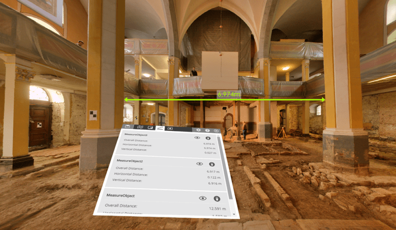

FARO’s first mainstream foray into the provision of virtual worlds is through the use of FARO Scene Software. Traditionally their documentation software for terrestrial and handheld scanning hardware it is clear that ‘documentation’ has moved on and now caters for the evolving demands of the industry’s current generation. The new enhanced Virtual Reality functionality permits viewing project point clouds in full detail; users can currently select between Oculus Rift or HTC Vive headsets to experience and explore on-site situations back in the office in an immersive environment. It’s easy too! The VR feature is an integral feature of Scene; clicking the ‘VR View’ icon, the view opens and is then driving the headset directly.

When viewing the scan data in an immersive environment, users can freely ‘wander’ the surveyed site. Rather than the ‘model’ being created by a gamer, what they are seeing is the same accurate data that drives any 2D deliverables. In this scenario however, the user can interrogate the survey in whichever manner they choose and in complete safety – not to mention avoiding inclement weather in the comfort of their own office!
The ability to view an environment in a natural way by peering around corners and looking up and down is a far more natural way to appreciate the details (intricate or otherwise) of any space.
The measurement/interrogation tools currently available to the user whilst viewing the data are useful and will build as the features mature – one can envisage perhaps checking as-built models against as designed BIM data sets, whereby any built elements beyond a given tolerance are highlighted – an exciting prospect!
