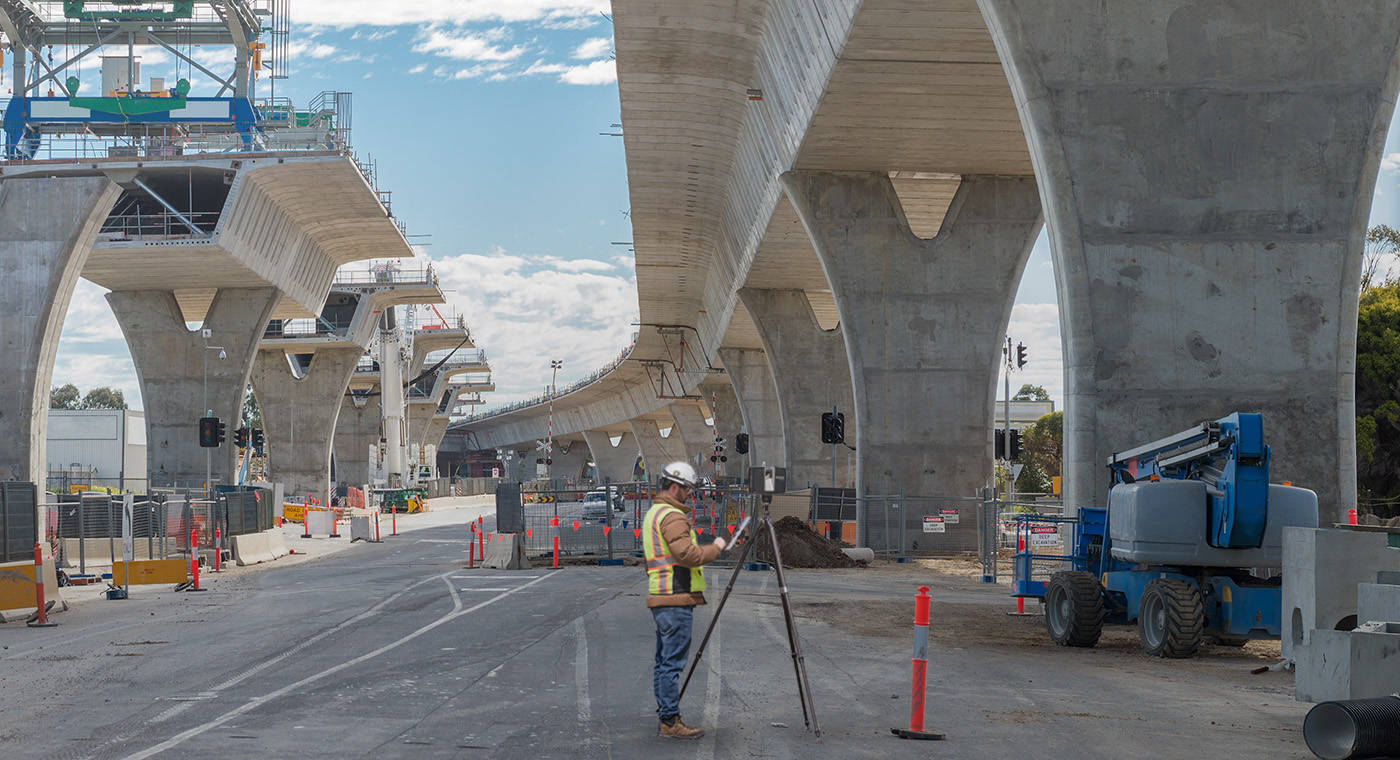

A bridge under construction with a man in ppe scanning using a FARO Focus terrestrial laser scanner
For surveyors, this means the ability to take accurate measurements and capture all dimensional aspects of a physical structure much faster than traditional methods. Additionally, Focus, with the use of control targets, allows for the capturing of multiple data sets, enabling the monitoring of any changes or movement of the structure.
