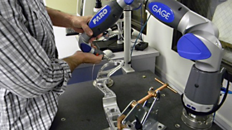

The solution to that restraint was to implement a portable CMM from FARO, the FARO Gage. The Gage has improved G5’s capabilities and met their needs in multiple ways. The device is very easy to use by both operators and inspectors and the software is easily interpreted and used for writing new measurement programs.
“We really like the fact that we can move the Gage out to the machining operation and check a part, a tool, a fixture, or anything that we need to without removing anything from the machine,” said Mr. White. “This is really a great asset in quickly and accurately verifying our processes and setups.”

The incoming inspection of bow riser forgings, for example, took 1-2 hours per batch to inspect the primary concerns of forging flatness and straightness. Using the FARO Gage, these same inspections can be done in 15-30 minutes maximum. That is a tremendous time savings. The estimated time and money savings for G5, just on these incoming forging inspections, have been multiple hours and at least $5,000 in just a couple of months.
