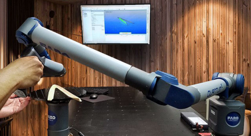

More than 5 years ago, the Tri-State team scheduled an on-site demonstration of the FARO Platinum ScanArm fitted with a hard probe.
“I was truly impressed with the speed and accuracy of the ScanArm,” says Peterson. “With the ScanArm, you could get in minutes the data that would take hours with a fixed CMM. Later that day the owner asked what I thought of the FARO presentation. My response was ‘Find a way to buy it. It’s exactly what we need.’ We purchased our first FaroArm® shortly thereafter and it’s provided years of good service.”
Tri-State subsequently added a FARO Edge ScanArm in 2015 and deployed a FARO Quantum 8-Axis ScanArm in 2019.

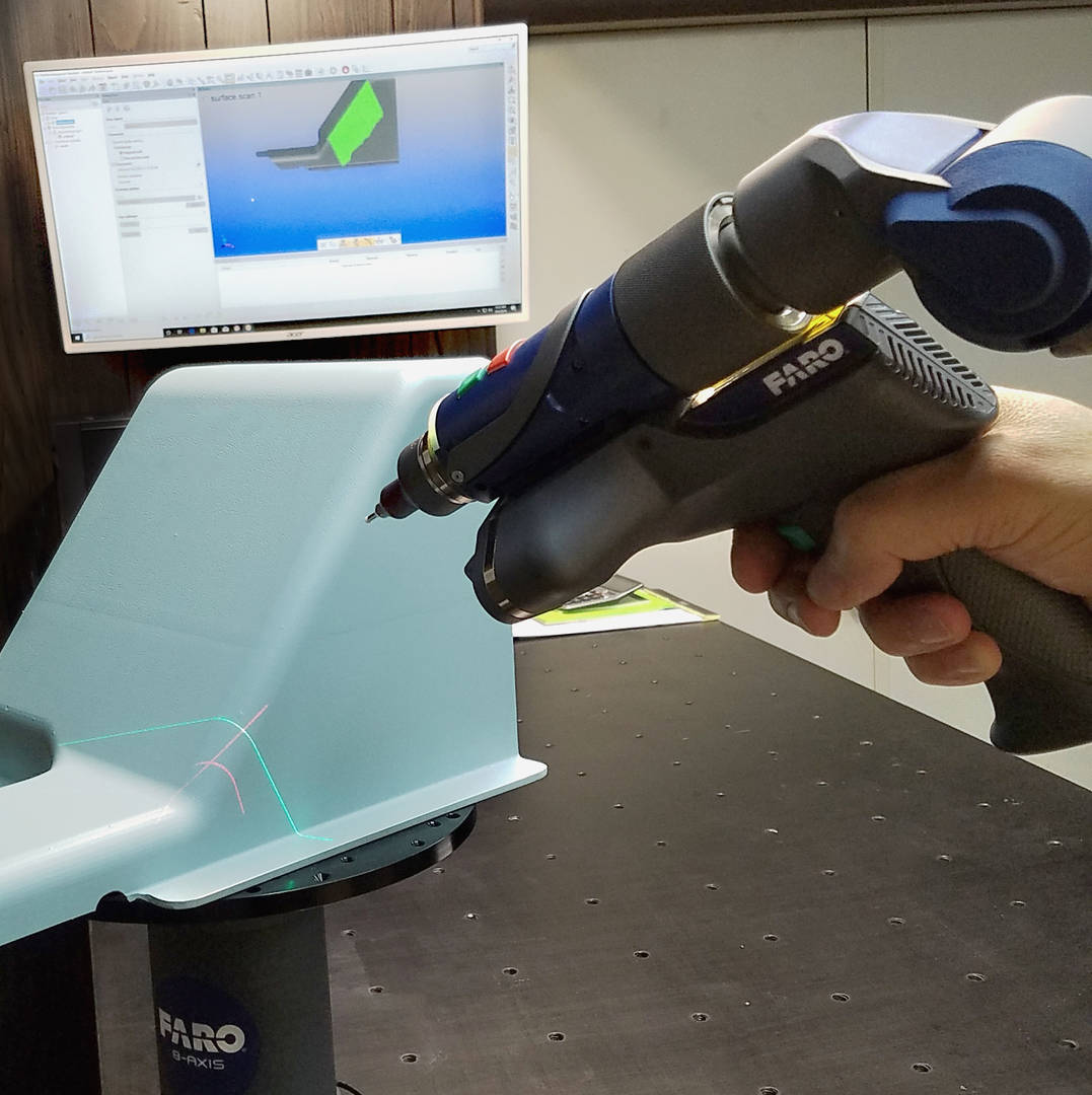

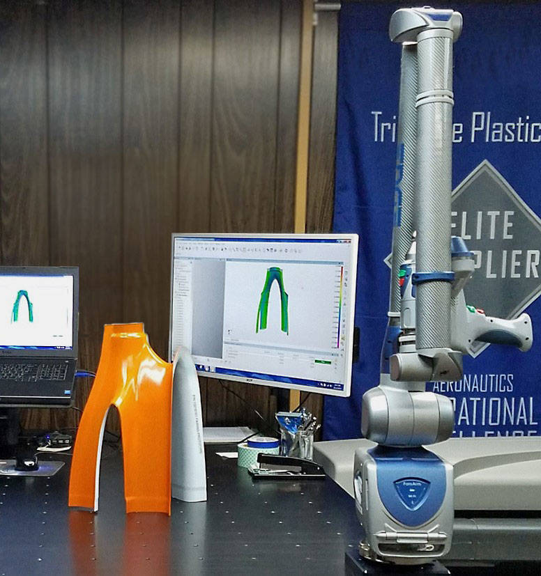

Tri State Plastics using an Edge ScanArm“There are large panels we used to inspect with traditional tools like calipers, straight edges and N-gages,” explains Peterson. “This used to be a two-person operation requiring four to eight hours. Now we can do it in about twenty minutes. As far as reportage goes, we were recording all these numbers longhand. We have inspection reports for some parts that are nine, ten, eleven pages worth of data. Depending on the size of the order, you have to think of it in days, not hours. A report that used to take two hours now takes about 15 minutes.”

Tri State Plastics using a ScanArmMike and Marc Lopez, co-owners of Tri-State, decided to purchase a QuantumE ScanArm with a laser line probe and a Quantum 8-Axis rotary table. The facility now has two fully operational FARO workstations with probe and scan capability.
“Matt proved to us the value of having scan data that we could check CAD-based parts with,” says Peterson. “It’s also great to have evidence of conformance that our customers can immediately and easily see.”

“By the time we finished all three families of parts within that contract, the Quantum Arm had paid for itself,” says Mike Lopez. “But that was only the first project. Since we bought the arm, we've already received more orders which we'll ship in another 30 days. So, this piece of equipment will have paid for itself in about 90 days. We can’t believe what we’re seeing.”
