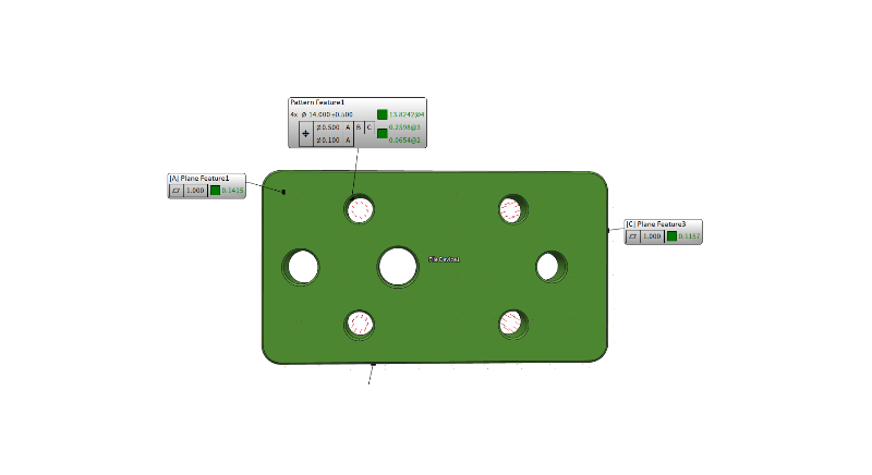

Composite tolerance with only primary datum in the lower segment
Hole pattern
Figure 3. Hole pattern with only primary datum repeated in the lower segment of composite position tolerance (created in BuildIT Metrology Software).
In Figure 3, we observe a composite tolerance created using BuildIT Metrology Software. The algorithms implemented in the software evaluate the measured features according to specifications of ASME Y14.5, explained in this post.
Hole pattern located by composite tolerancing

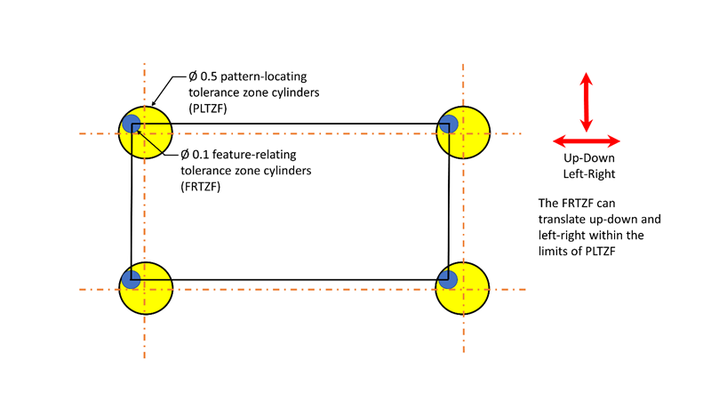

Figure 4. Hole pattern located by composite tolerancing (Primary datum only in lower segment). This figure represents one of the possible displacements of the pattern. Note that the yellow and blue circles represent the tolerance zones with 0.5 mm and 0.1 mm diameters, respectively.
Figure 4 shows the tolerance zones and their functions for composite tolerances with only primary datum in the lower segment:
Yellow Tolerance Zones: Pattern locating tolerance zone framework (PLTZF).
Blue Tolerance Zones: Feature relating tolerance zone framework (FRTZF).
The PLTZF constrains the location and orientation relative to datum ABC.
The FRTZF:
  1. Constrains the location and orientation of individual hole features within the pattern
  2. Constrains the orientation only relative to datum A
The axis of the holes must reside within the tolerance cylinders of both the PLTZF and FRTZF.
Animation showing hole pattern located by composite tolerancing
Figure 5. Animation showing hole pattern located by composite tolerancing (Primary datum only in the lower segment). Any of the displacements in this animation represents a possible configuration for composite tolerancing with only primary datum in the lower segment. Note that the yellow and blue circles represent the tolerance zones with 0.5 mm and 0.1 mm diameters, respectively.
In the animation in Figure 5, the yellow tolerance zone pattern designates the PLTZF and the blue tolerance zone pattern designates the FRTZF.
Again, the important difference between the upper and lower segment is that in the lower segment, the tolerance zones are only constrained in orientation with respect to datum A. The lower segment does not locate. Thus, the blue tolerance zones (the FRTZF)
nly in rotation (they must stay perpendicular to A), but they are free to translate and free to rotate with respect to datum B or C and stay inside the larger tolerance zones.
Note that in certain positions, portions of the smaller blue tolerance zones can fall beyond the limits of the larger yellow tolerance zones. However, these portions of the smaller tolerance zones are not usable because the axes of the features must not violate the limits of larger tolerance zones (ASME Y14.5-2018, 10.5.1.1).
