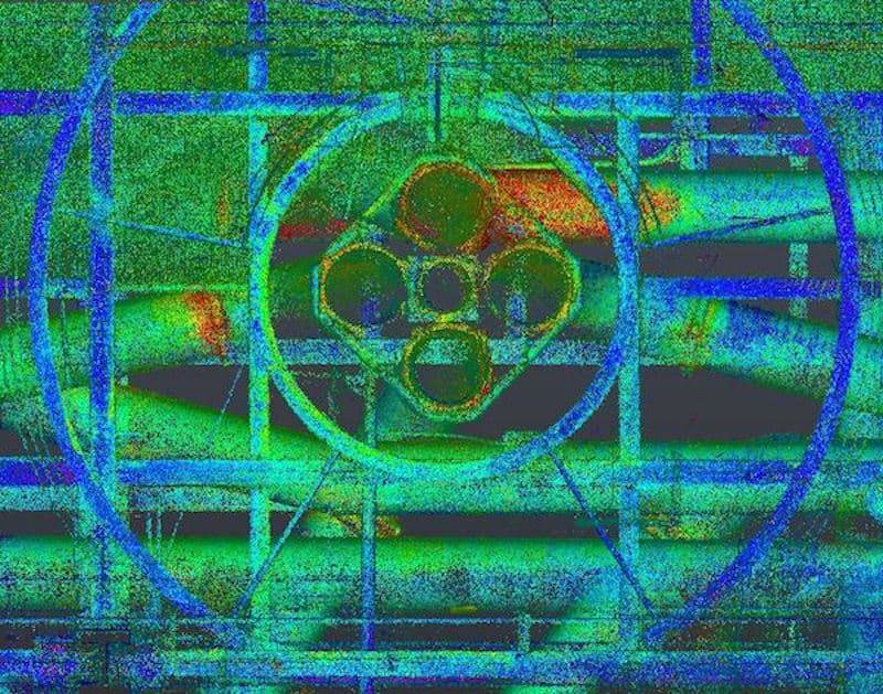

Pulverizers-Isolated-Cross-section-looking-up-Single-Pulverizer-Outlet-Point-Cloud-SMALL

As a result of recent successes on multi-million dollar projects and digital visualization for Georgia Power, plant management requested Acensium’s involvement during the planning phase. Acensium demonstrated what would be able to be done with example scans to illustrate for project leads what was possible. Georgia Power recognized that the project could not be accomplished without 3D scanning project control and so Acensium utilized the FARO® Focus Laser Scanners and SCENE Software.
Had more traditional methods been used instead, the process would have included arduous and time-consuming tasks of measurements, estimation and guesswork to determine what changes had been made since the original design from decades ago. As a typical project team cannot simply look at 2D as-built drawings and understand the full scope of what is going on, the use of 3D scanning gives insight to the whole team. With a building constructed around the equipment, clearances are at a minimum. Understanding the operation and arrangement of every pipe and support was crucial for project success.
With a facility that has been literally built around installed power plant equipment in 1975, everything had to be mapped for success. There were no clearances designed-in for removal or addition of components as you would see in a facility built before equipment is installed. Every support beam, pipe, bracket and bolt needed to be accounted for to ensure that components can come out of (and into) the facility as needed. For example, a 50-foot pipe may need to be replaced in 10-foot sections instead of the original 50-foot solid length. There may simply be no way to get 50 feet of pipe into the building if not sectioned out. To that end, FARO 3D scanning technology, coupled with a highly skilled team, was paramount.

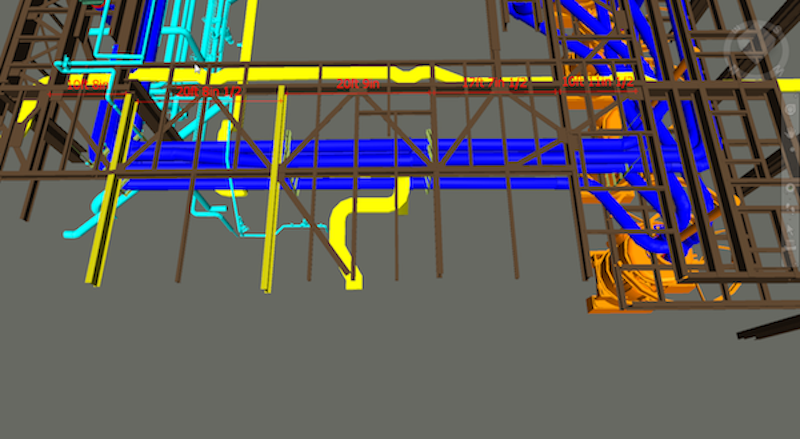

Pipe Model
The Modeling Aspect
Dynamic visualization was used to show parts moving in and out of the constricted project area. The modeling was a mix of clash detection and project process planning. Visualization was also used to enhance communication between project stakeholders.

FARO Focus hardware and settings dealt with constant high vibrations. Care had to be taken in a high-heat environment with human exposure-time. FARO equipment operated for hours in a high-heat environment at 120 degrees F to produce key scans.
