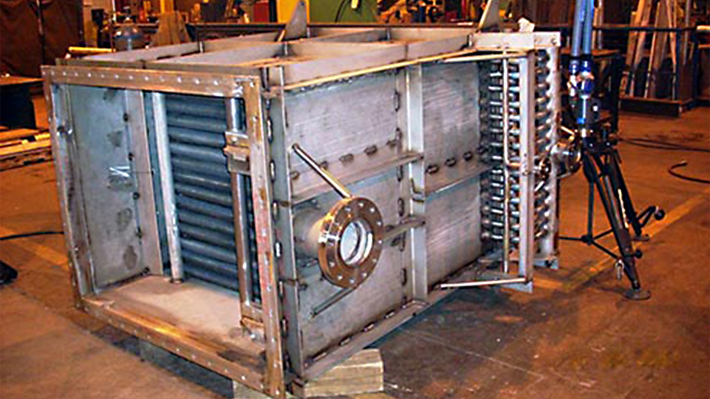

One product, large air-cooled, high-temperature heat exchangers that are the subject of this case study are produced in three sizes: what CBW calls a 300 size which is 25” x 25” x 54”, a 1500 size which is 49” x 80” x 79”, and a 3000 size which is 87” x 100” x 109”. To properly inspect the 300, there are approximately 62 different features and 80 constructions that must be measured. The 1500 raises these numbers to 150 features and 280 constructions while the 3000 raises them even higher to 200 features and 290 constructions.
These exchangers have structural bolting flanges on the shell side and finned tubes with pipe headers on the tube side. CBW must measure and report the tube side flanges relative to the centers of the structural flange bolt hole patterns. They must also report the integrity of the structural flange bolt hole patterns themselves as they tend to distort after welding.
To get these measurements, CBW would use a combination of levels, plumb bobs, tape measures, straight edges, and a geometry-based metrology. By virtue of the construction of these units, there were many features that could not be measured using analog methods like these. Once completed, the largest unit weighs nearly eight tons and the shell-side passage is completely blocked with a finned tube array. This means that once completed, the only access to the bottom from the top is around the side of the unit.
Imagine that the perimeter of the top of the unit is a rectangular bolting flange with 48 holes and the bottom is a bolting flange with 52 holes. These patterns must be measured and each hole located to within 3/32”. Then the bolting pattern centers must be located within 1/4” of one another in two dimensions.
The analog methods of measuring were a mixture of not capable, not accurate enough, too complicated, and had the potential for human error with the manual reporting required. These tools and methods also introduced many variables that could alter measurement accuracy.
For example, when CBW tried to find if a connection was centered between two rows of bolt hole centers 100 inches apart, they first had to “fit” the rows to separate lines and measure toward the connection perpendicular to one of those lines. It is difficult to find a flanged connection center (center of an ANSI flange bolt pattern) and then to determine if this center is midway between the bolt hole rows within the required 1/8”. This required analog reconciliation of potential variances in the bolt hole rows, the bolt hole diameters, and the flanged connection manufactured tolerances. It was basically trying to measure between two imaginary points that result from a best fit of 4 to 28 features within that 1/8” over a distance of 50 inches. This proved VERY difficult, if not impossible, using traditional, analog tools and methods.

Until the purchase and implementation of a FaroArm and CAM2 software, there were a number of features that were requested by customers for measurement that simply were not possible using analog tools and methods. In the example of the fabricated bolting flange patterns that are measured relative to the pattern center as well as other features relative to this same center, the FaroArm made it possible to measure and report these and other features. The CAM2 software and its iterative capabilities provided CBW the insight into fabrication methods and sequences that helped them eliminate unit-to-unit variances in manufacturing. This yielded a more consistent and precise product. The type of depth in quality the FARO system offered cemented the end customer’s confidence in CBW’s product.
It’s an interesting application in that CBW calculates imaginary (non-measureable) center points of a rectangular bolt hole pattern and reports the centers of pipe header outlets relative to those points. The software must also perform an iterative fit of these structural flange bolt hole patterns and report any holes that fall out of “tolerance” in order to give a “real world” bolt-up acceptance or rejection. In this particular application, it’s sort of like an advanced go-no go gauge on steroids. What makes all of this especially interesting is that this is done with five device positions while holding 1/8” tolerance on a fully welded assembly with many feet of weld between measured features.
Because of the blocked shell-side passage on the heat exchangers, a number of device moves (leapfrogs) must be performed to construct each flange from data taken in four different positions. Leapfrogging is a technique used with portable measuring devices like the FaroArm that extends their working volume by measuring reference points in one position and again after moving the device to a new position. The reference points link to the new device position, allowing for measurements to be taken and reported in the same reference frame.
The level of measurement that CBW was looking for, up to five device positions with so many features and constructions, initially took some time and a healthy dose of help from FARO customer service to develop. Applications Engineer Todd Wilson helped to develop a core programming and methodology for a single product size. Once the alpha version was reached and consistency in measurement was established, it took as little as a half a day to train additional operators on how to use the FARO system with the alpha programming. Once the beta version of this programming was complete, implementing an inspection process and optimizing the software to achieve their goals of adding features, constructions, coordinate systems, multiple alignments, and corresponding reports was a matter of specifying the setup to the shop and providing the time to perform the measurements.
Originally though, the programming had one coordinate system alignment based on part features that was used only to measure the final product. Since that first program, CBW has integrated two more iterative alignments used to report large bolt patterns of 48 or more holes and their conformance to tolerance independent of other unit features. The programming uses a portion of the measurements for one alignment, generates a report, uses a new set of features for another alignment, generates a report, and finally the last alignment with a third and final (overall) report.

Over the last three years, approximately 37 units have been built and measured using the FARO system. In this time, the measurement procedure has increased in depth from just a final measurement of a finished unit to preliminary measurements and measurement of individual fabricated components before assembly even begins. For each, FARO has been successfully used.
“We have been able to reduce the variance of in-process placement of key features from as much as 7/16” to 1/8” from one unit to the next,” said Marc Dinsmore, Mechanical Design Engineer at CBW. “The FARO system has allowed us to become so consistent and accurate from build to build that the largest cause of variance between builds has become the actual mill tolerances on the raw material being used!”
