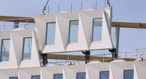

A: Prefabrication, or prefab for short, is manufacturing individual components to be assembled in a factory and shipped to a site, instead of being built manually on site. It’s also called “off-site” or “modular” construction. A lot of diverse industries use prefab manufacturing. Steel, timber, precast — including concrete — all use prefab. Modular housing is a huge industry that uses prefabrication.

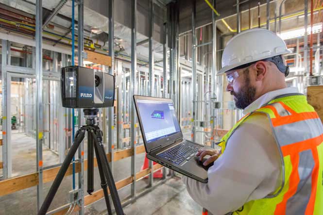

A: There’s consistency in the process. When you’re building something manually on site, the same part may be built slightly differently each time. The more error in the process, the further away you stray from design intent. And that’s the same consideration with construction QC as well. The reason we scan as we build new buildings is to verify we’re in line with our tolerances and that we’ve stayed aligned with the architect’s original design model.
By building off site in a controlled environment we can follow a more standard process. We don’t have to deal with changes in the elements or human variation. Even before the product leaves the warehouse, we can measure the final module to verify it’s ready to ship, so there’s no surprises when we’re assembling on site. The standardization is built into everything, so there are far fewer mistakes. And fewer mistakes means more savings, less waste and more safety.
