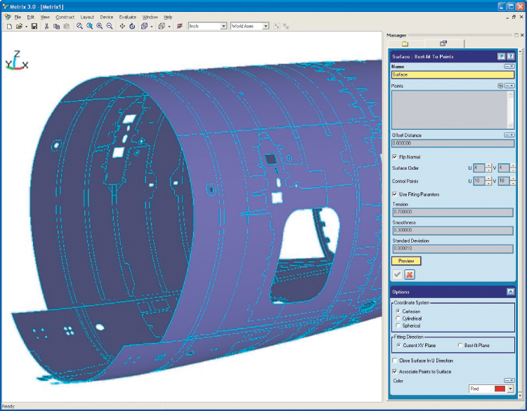

 complete measured and engineered mid-aft fuselage assembly
The complete measured and engineered mid-aft fuselage assembly with fastener locations.
Measured point-cloud data from trackers and arms is used to reverse engineer hole locations, panel edges and cut-outs. Curves are passed through the measured edge points to form surface trim lines and these are used to fit a free-form panel surface. The reverse engineering capability of BuildIT allows Gulfstream to verify the surface geometries and quickly identify where they need additional data points to correlate the 3D CAD model and the physical model within the required tolerance. Once this process is finalized, the newly created digital model is loaded directly into the CATIA engineering environment, with complete design data including rivet hole locations and other panel features. The model is used to produce the automated assembly programs. The ability to load files directly from BuildIT into the CATIA environment means the engineering team can easily retrieve the design data with complete reliability. Likewise, modifications can be communicated quickly back to manufacturing, for maximum engineering efficiency.
