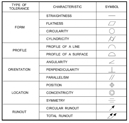

Types of GD&T Tolerances
Chart showing the different types, characteristics, and symbols of GD&T tolerances using the ASME Y14.5 standard.
