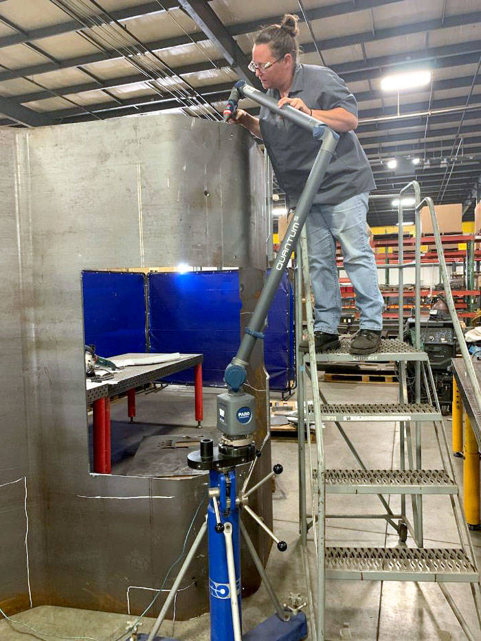

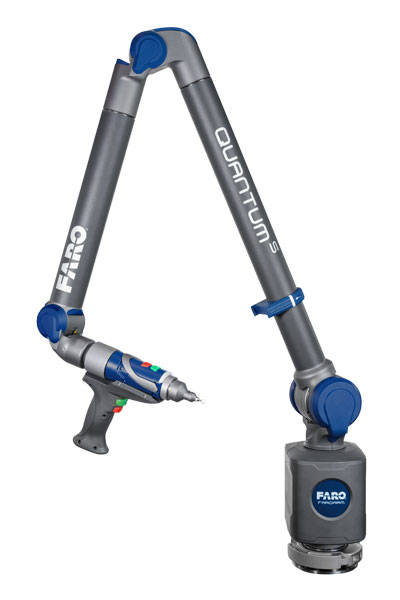

Quantum S ScaArmPlasan chose a four-meter QuantumS ScanArm outfitted with a FAROBlu® Laser Line Probe HD high-definition camera as the main weapon in their inspection arsenal. The FAROBlu uses the most advanced complementary metal-oxide-semiconductor (CMOS) technology to deliver a fast frame rate (the number of times per second that the camera gathers new data on the part being scanned) of up to 600 frames per second.
“The QuantumS is so much more efficient,” says Foley. “I seldom have to leapfrog with it. I can either reach all the features that I need to on the part or only have to move it once, which significantly reduces both time and the risk of measurement errors.”
In some situations, dimensional measurements are being made while the part is still on the brake press.

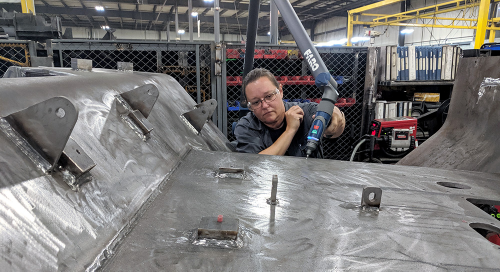

“Especially when we're doing prototypes and first-offs, having Christine there verifying and working with engineering to make the corrections in real-time drastically reduces the time to get that bend correct,” stated Bellitto. “Most of our layout work is done near our brake machines on purpose. The flexibility and mobility of the QuantumS is a real asset.”
Quantum S being used at PlasanPlasan relies heavily on their QuantumS for launch activity and any incoming subcomponent verification, such as submitting PPAPs (Production Part Pre-Approval Processes) or FAIs (First Article Inspections).
“We have a couple programs that we run on a day-to-day basis for features like welded fixtures that have to be qualified every six months or once a year,” explains Foley. “There are many non-fixtured parts that we have to inspect before they go out the door, so we may measure at the component level first and then, once they're welded, either I go to them or they come to me for a final inspection on the end product.”
