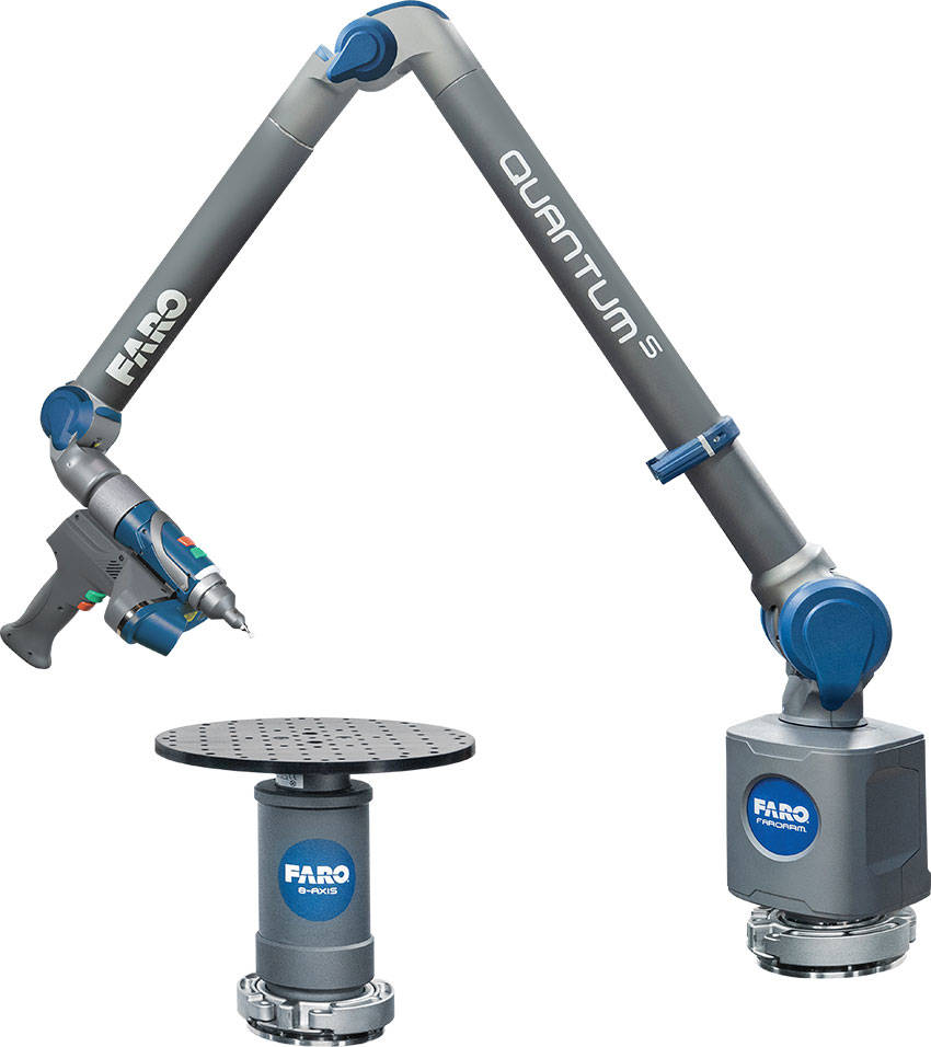

To aid them in their efficiency and profit-earning quest, Metal Assemblies purchased a 2.5 Meter capacity, FARO 8-Axis Quantum ScanArm featuring a Laser Line Probe and advanced, integrated 8-Axis rotary turntable capabilities.

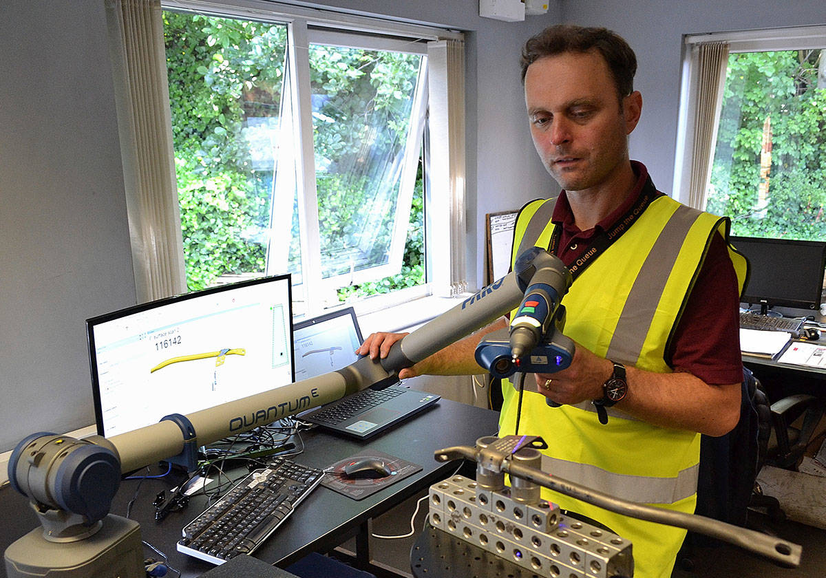

“Although we have a high-specification, fixed Coordinate Measuring Machine, it is unable to make the surface scans that we need when performing work such as product development,” Bullows explained. “Therefore, for some time we have been outsourcing this work. As the volumes of subcontracted 3D scanning work grew, it recently reached a level where it became feasible to purchase our own scanning device. Having considered equipment from other metrology companies, following an excellent demonstration, we came to the conclusion that the FARO 8-Axis Quantum ScanArm fitted with the company’s FAROBlu Laser Line Probe was perfect for our needs.”
The advanced FARO product seamlessly integrates a FARO Quantum ScanArm with an eighth-axis, making the FARO 8-Axis Quantum the world’s first eight-axis portable coordinate measuring machine (PCMM).
Ideal for Metal Assembly’s use, the company ordered its 8-Axis Quantum ScanArm fitted with the FAROBlu™ Laser Line Probe. Blue laser technology enables extremely fast scanning and delivers excellent results even on complex, dark, and reflective materials, common in automotive applications.
As the first portable CMM arm in the market to be internationally certified to ISO 10360-12 standards, FARO provides a superior inspection tool solution, setting a new industry performance bar, and ensuring maximum measurement consistency and reliability. The FARO 3D measuring arm can perform in a wide range of work in conditions, including operating in extreme temperatures and in shop floor situations.
An industry exclusive, the integrated 8-Axis rotary scanning platform decreases scan time by up to 40%, with no loss of accuracy. There is no need to move around an object to scan it, instead, users simply rotate the platform as they probe or scan the part under inspection.
“After our FARO training sessions, we are quickly becoming competent in the Quantum’s use,” Bullows added. “In addition to performing all of the 3D scanning tasks that we previously outsourced, our FARO Quantum ScanArm is now proving ideal for a range of tasks such as first article inspection (FAI). Given the speed and accuracy of our new FARO device, once our parts pass FAI our production processes can proceed with confidence.”
