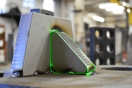

Laser Projection is used when throughput needs to be increased, scrap and rework need to be decreased, and accuracy needs to be improvedLaser Projection is an assembly assistance tool that guides operators through the build process by projecting a visual template onto the work surface. This template is generated directly from a 3D CAD design model, ensuring up-to-date and accurate information. This information is created and stored, ahead of time so the operator of the system has all of the information needed at the time required. The laser projector displays a laser image on the work surface outlining parts for welding, hole locations for drilling, or other assembly operations. Users quickly and easily cycle through the build procedure following the steps as they are laid out in front of them.
A laser projector creates these accurate images using very precise turning mirrors that steer the beam through space. Known reference points are located to create a virtual alignment of the projector onto the coordinate system of the part. This best fit enables the projector to provide high-accuracy projection images. These mirrors allow the system to project any type of part geometry that may be required. Laser projection can be used to project on areas from 6-50 feet, and if a larger volume is required multiple units can be used together for full coverage.

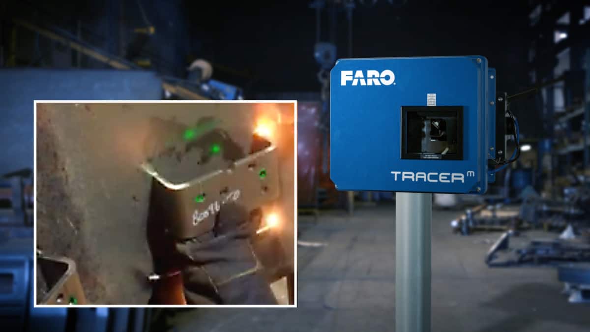

Projection reduces the need for tape measures, physical templates, and toolingThe precision system displays highly accurate templates that may result in a 50% to 75% reduction in build time and an 80% to 100% reduction in rework costs, based on information from some of FARO’s TracerM users.
