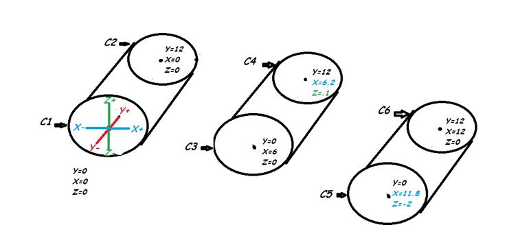

Step 2
With most roll alignments, the goal is usually to align to a reference, such as monuments or perhaps to a drive roll. This is where I would create a coordinate system. Next, measure a plane and circle on both ends of each roll. You want to measure circles because they are point reducible which makes it easy to verify if the rolls are in or out based on the coordinate value of the circles center point. Based on how the coordinate system is setup, I normally make Z+ represent my elevation, X+ to be the distance between rolls, and Y+ to be the length of each roll. By simply looking at the X and Z values of each circle, I can check to see if the rolls are level and equally spaced. Take a look at the sample below.
If you notice circle C4 the X value is 6.2 and the Z value is set to 0.1. So to correct this we would simply move the C4 end of the roll into the –X direction by 0.2 and down in the –Z direction by 0.1. You would simply repeat this for the rest of the rolls.
So with proper setup and the use of coordinate systems, roll alignments can be performed accurately and save a lot of time and labor cost in the long run.
