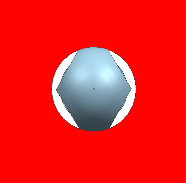

Diamond pins are used to overcome overconstraint problems while keeping manufacturing costs low. A diamond shaped pin controls the dimension aligned with its widest axis precisely while allowing larger variation in the other axis (Figure 1). Information on diamond pins and their use can be obtained through various manufacturers [2].
Diamond Pin
Figure 1. Diamond Pin.

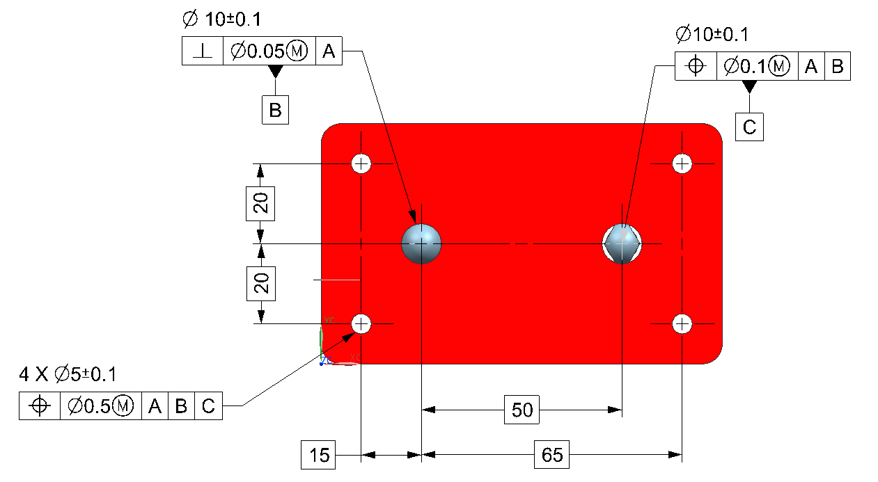

Next, we apply the geometric dimensioning and tolerancing principles defined by the ASME standard [3] to a part designed for diamond pin application:
Diamond Pin Application
Figure 2. Part designed for diamond pin application with tolerances applied (Primary datum feature (A): The flat plane at the bottom – Not Shown)
In Figure 2, we can observe the following:
  • Primary datum feature (A): The flat plane at the bottom of the workpiece (Not shown).
  • Secondary datum feature (B): The hole defined with a feature size tolerance of ±0.1 mm and a perpendicularity tolerance of 0.05 um with respect to datum feature A.Tertiary datum feature (C): The hole with a feature size tolerance of ±0.1 mm and a position tolerance of 0.1 um with respect to datum reference frame AB.
  • The 4 hole pattern: The holes in the pattern have a feature size tolerance of ±0.1 mm and a position tolerance of 0.5 mm at MMC with respect to datum reference frame ABC. The position of these holes is defined with basic dimensions with respect to the datum reference frame ABC.
Lastly, it must be stated that diamond pin applications are particularly useful if your part has an important thickness and must be machined by a milling machine. For sheet metal parts manufactured with stamping processes, the use of slots can be a better solution.
