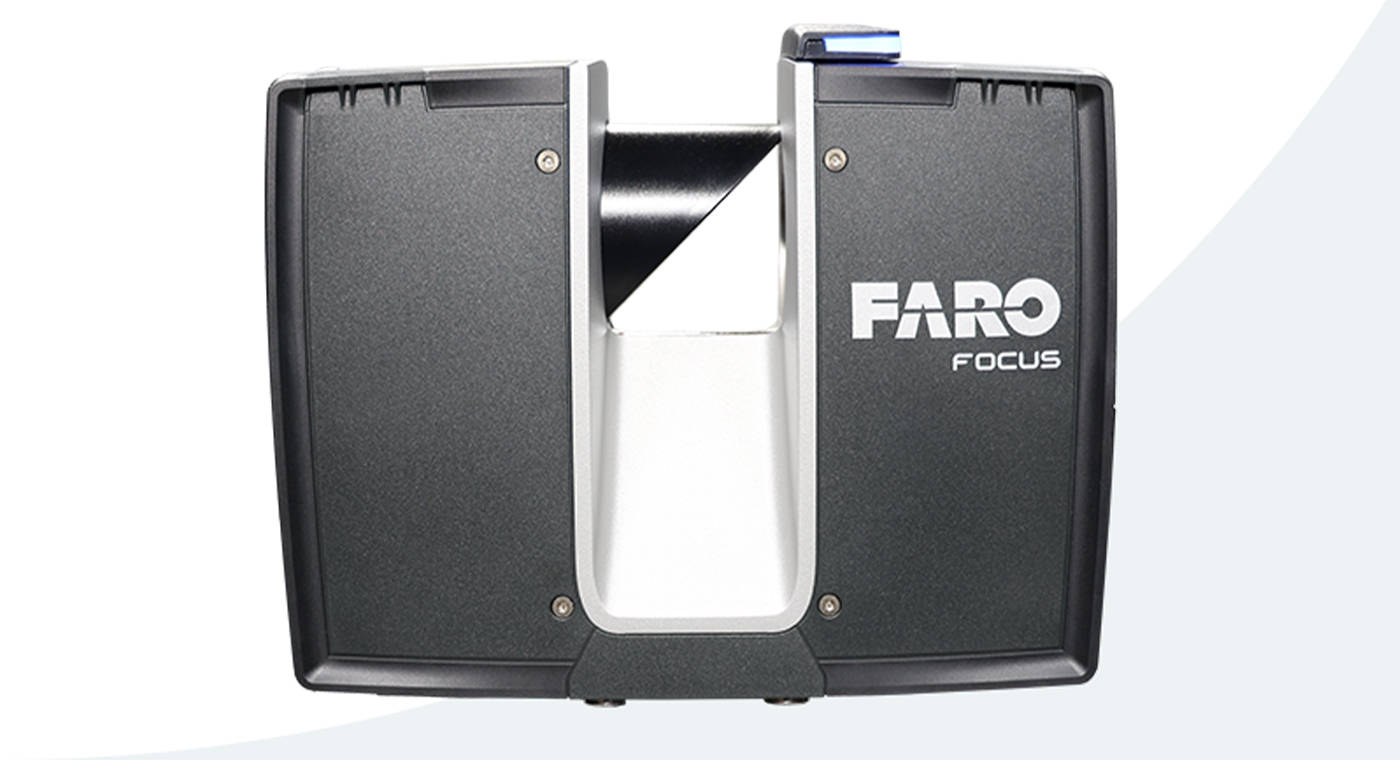

While not marketed as heavily for this specific target audience, the FARO Focus Premium Laser Scanner, known broadly for its architecture, engineering and construction applications, is also a fully viable solution for a variety of 3D measurement tasks. Namely this breaks down into three subcategories:
  • Enhanced Product Design and Engineering: When a product lacks CAD data, the Focus Premium can scan a large part or entire assembly with excellent speed, detail and accuracy to create a 3D model, ideal for reverse engineering purposes. This also allows users to take the 3D model and compare to reference data, noting when any deviations occur, useful for clearance checks as in train tunnel, or if a construction crane is street-legal width.
  • More Efficient Production, Fabrication and Assembly: Scan complex machine components, use the resulting 3D CAD data and dimensional control for precise-fit off-site assembly as needed, or simply use the data for manufacturing documentation.
  • Improved Quality Control and Part Inspection: Perform precise dimensional inspection of large, complex components such as bodyshells, turbines and ship propellers through a standard CAD comparison that you’re used to performing with other 3D metrology devices such as Laser Trackers or ScanArms. This is most useful for large vehicles, heavy machinery industrial and machinery assembly. Think: truck and trailer parts, tanks, and cranes, for example.
  • Assembly Check: Use the 3D data to check a large-part assembly to understand whether all components are present, at the right position and orientation. The Focus Premium enables the shift from a pure human-based, visual check to a data based, traceable analysis.
The key to each of these applications is the above-mentioned speed and accuracy. 3D laser scanners like the Focus Premium operate at the threshold where most portable coordinate measuring machines (pCMMs) reach their large-part scanning limit. While they may exceed a Focus Premium in terms of accuracy, they are more cumbersome to re-position, and larger parts will take many re-positionings.
This speed-bulk challenge is also faced with products like the FARO Laser Tracker – ideal to check main geometries with higher accuracies – but less suited for tasks requiring lower granularity inspection. For instance, a customer that builds heavy duty logistic equipment must inspect the bodyshell before final assembly. With a tracker a task like this might take more than five hours to complete. Using a Focus Premium in manual mode the same task can be completed in as little as 20 minutes for the entire workflow, a more than 90% decrease.
