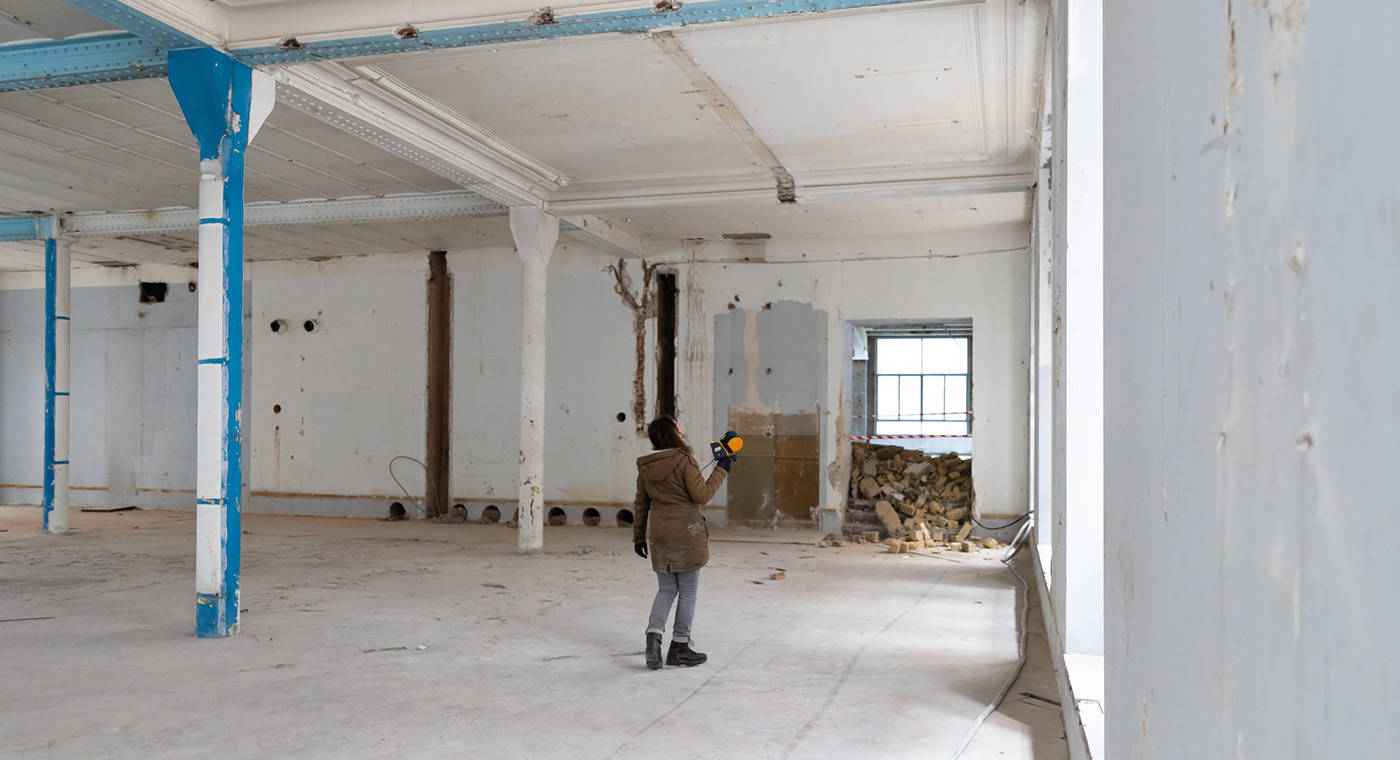

Lady scanning in an abandoned building using mobile LiDAR

Mapping a room with LiDAR can be a quick and easy process, depending on the type of laser scanner that you use. With GeoSLAM's handheld LiDAR scanners, you simply walk around the area you wish to capture whilst holding the device steady and then process the collected data in GeoSLAM Connect.
