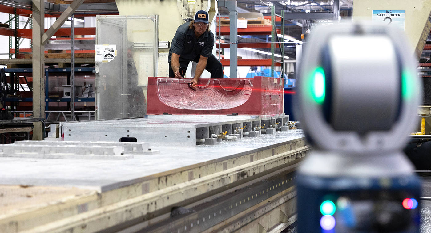

Traditionally these boards of beauty were made by hand. Today, most are made with a CNC (computer numerical control) machine. According to Surfer Today
Of course, in order for a CNC machine to do its job properly, it must be checked to ensure what it’s cutting is within tolerance; that the parts that comprise the machine itself haven’t broken down and that the surfboards it creates are within tolerance for what the CAD model indicates is correct. That’s where 3D metrology laser trackers can assist — the unspoken “heroes” of the entire surfer community. Because without this critical quality control safeguard, an improperly calibrated CNC machine could mean a finished product that fails its own quality control on first article inspection, resulting in: fewer sales, more returned product, or worse, increased surfer injury, negatively impacting an estimated $10 billion industry.

Despite these numerous applications, some industries have avoided adopting laser tracker technology based on outdated perceptions of how difficult they are to use. Typically, measuring was a intensely manual effort requiring absolute line-of-sight between the laser unit and the SMR – if anything got between the two, the beam would be broken and the sequence would have to start again. Operators needed more extensive training and experience to use the Laser Tracker efficiently.
Recent innovations, however, have mitigated this concern by allowing the laser to actively locate and lock onto the target even if the line-of-sight beam is broken. Consequently, operators can begin using the technology without needing rigorous training and the time needed to measure large or complicated objects is dramatically reduced. Additionally, using an accessory such as a 6Probe provides wireless, hand-held assistance when measuring hidden or hard-to-reach areas through its 6 Degrees of Freedom (6DoF) capability. These features make laser trackers a widely-applicable, rapid and easy-to-use solution.
