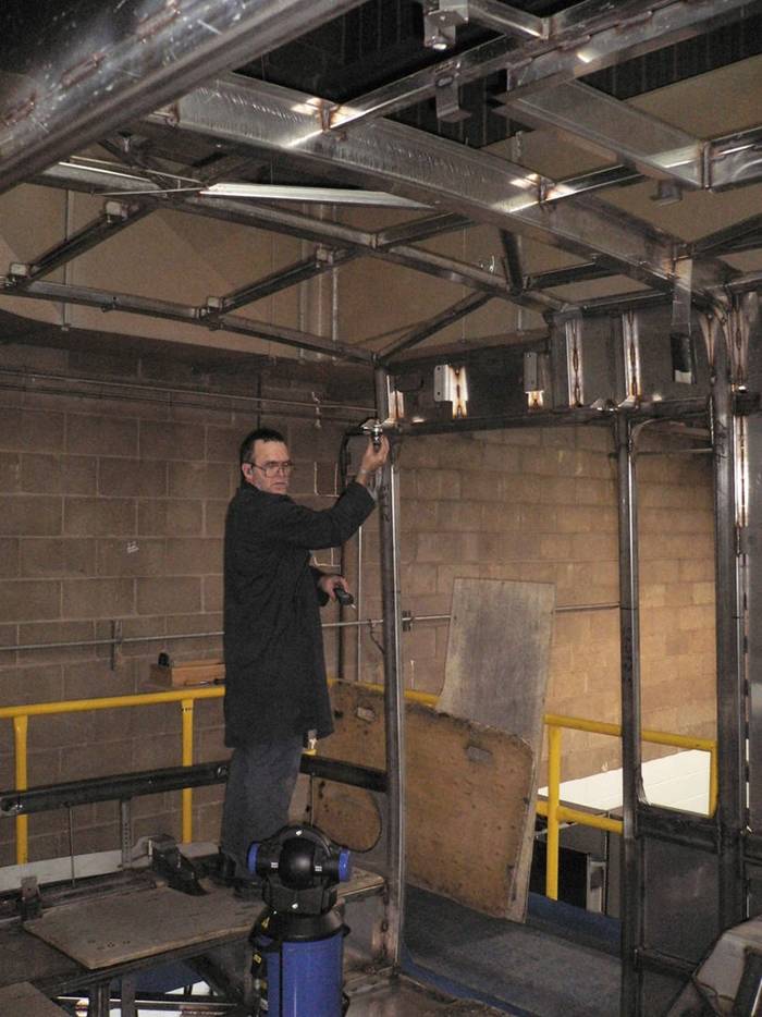

Current frame inspection required two inspectors and took up to five hours per bus. A portable coordinate measurement device combined with manual techniques measured the bus in multiple sections. The time consuming process required significant paper-based recording and analysis, as well as careful verification to ensure the accuracy of information. “Our goal was to make inspection a three hour procedure to be performed by one inspector. We also wanted produce digital records of all inspection information,” stated Alain Conraud, Section Head, Technical Services at Novabus. Additionally, Nova Bus wanted to reformat the inspection reports to make it easier for shop staff to interpret, and make the information accessible to support the final assembly process.
Working closely with Nova Bus, BuildIT created a plan that included portable CMM hardware and new measurement software for a paperless inspection process. In the first step towards implementing the plan, BuildIT worked with Nova Bus to identify and acquire the most effective CMM technology to support the new process. A new laser tracker would complement their existing portable arm, and enable them to transition to an entirely digital measurement process.

Within a few months of implementation, Nova Bus realized an 80% time savings. Engineers at BuildIT created automation routines that guide the inspector through one-button measurement. Inspectors follow a sequential multi-station process that ensures consistent and repeatable measurement. What used to take ten man-hours to complete could now be accomplished in two hours – a full hour less than Nova Bus’ original goal.
BuildIT’s unified software interface simplifies the process of working with multiple devices. The same one-button measurement process collects data from both the arm and the laser tracker and all measurement data is easily merged into the design coordinate system. BuildIT facilitated measurement and understanding of intricate geometries like door frames that were previously measured by hand. For the first time, Nova Bus is able to analyze dimensional data across the entire vehicle without having to manually manipulate the data.

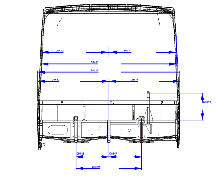

Nova Bus benefits from powerful reporting capabilities of BuildIT. Hundreds of key features are inspected against tolerance and exceptions are highlighted in color-coded 3D CAD reports.
A complete digitized inspection process and customized reports make inspection results immediately understandable.
