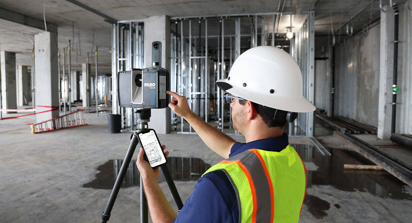

The variety of LiDAR scanners has expanded over time, and each development brings new opportunities. LiDAR sensors are used in terrestrial laser scanning (TLS) to capture extremely dense and accurate data, mounted to drones for coverage from the sky, or attached to handheld devices for obtaining accurate information from hard-to-reach areas. More recently LiDAR sensors have been included in smartphones, reaching even more people interested in the technology, albeit at a cost to accuracy.

Mobile LiDAR solutions are ideal tools for civil engineers. Rapid and accurate data acquisition makes the process of mapping repeatable, which is ideal for many of the applications listed above. Additionally, the handheld nature of the scanners makes mapping difficult-to-access areas possible, and the versatility of the scanners enables the use of accessories (e.g. UAV data capture).
